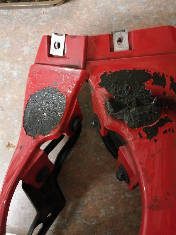

The lower fairing infill pieces were covered in a self adhesive heat reflective material which I took off today as they're looking a bit shabby.
What I saw horrified me.
I've heard of paint bubbling as a result of the heat from the headers but mine are like burnt toast.
I'm amazed this wasn't the subject of a safety recall.
:shock:

This is similar to what can happen to the 'Sharks Fins' on the R1100RT.
One cause, and it only has to happen once for the damage to be done, is that the bike has been left idling on the Mainstand or in stalled traffic for too long which causes the Header Pipes to glow red hot through lack of cooling airflow.
An even more disastrous consequence of the above circumstance, is that the engine oil and the engine crankcase overheat causing the Oil Sight Glass to pop out under crankcase pressure immediately losing 2/3 or more of the engine oil.
I had a situation many years back with my R1100RT where I had it idling on the Mainstand just prior to setting off and was distracted by an incoming landline telephone call.
After 30 minutes I remembered about the bike - I could smell the heat and the oil before I even saw it - the Shark's Fins were burnt and blistered and the side fairings above the cylinders were buckled - but the Oil Sight Glass had stayed put.
Never again did I leave my bike idling when unattended and I always ride off within 2 minutes of starting or shut off the engine.

There is a warning "Not to leave the bike idling" in the Owners manuals as damage to fairing lowers may occur
My manuals in Japanese which is my excuse but its still not very good is it.
Crawling through heavy traffic at a few mph is pretty much the same as idling, so perhaps they should have warned owners not to use their bikes in heavy city traffic.
The thing is it would have been such an easy thing to resolve.

I think anyone with a hint of mechanical knowledge (sympathy?!) would realise that any aircooled engine that doesn't have a fan of some sort will overheat in the right (wrong!) conditions - it's not rocket science really. Perhaps owners who'd moved from a more mainstream engine design were blissfully unaware....until they wondered what the noise and smell were! :lol:

Usually after an engine overheats damage will occur.
Very often the cylinder head is the first victim.
The problem here is quite simply that the plastic infill panels are sighted too close to the header pipes, not necessarily overheating of the engine itself.
These bikes have an oil temperature gauge.
The hottest conditions I've ridden my bike in was in the south of France where I was trickling stop start through tail backs at a walking pace in unbearable heat for about 30 minutes.
The oil temp did rise, but not significantly above the normal range.
